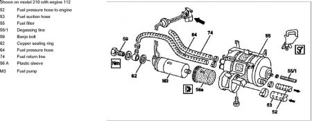

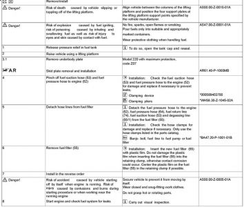

Where is the fuel filter located on this car? How do I get at it?
Feb 3, 2010 at 1:28 PM
  • 75,992 POSTS
2005 Mercedes Benz S 500 4MATIC (220.184) V8-5.0L (113.966) Fuel filter:
https://images.2carpros.com/forum/automotive_pictures/12900_fuelf_3.jpg
https://images.2carpros.com/forum/automotive_pictures/12900_fuelfilter_2.jpg

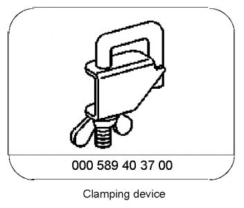

Special Tool
https://images.2carpros.com/forum/automotive_pictures/12900_tool_4.jpg
