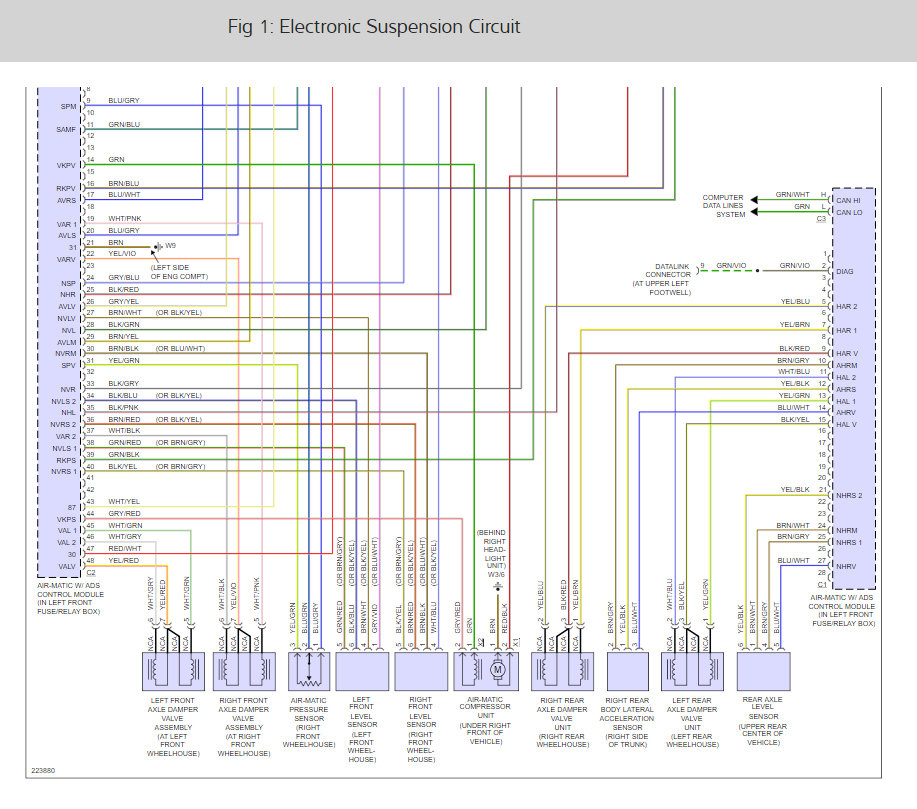

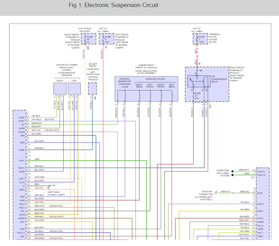

Hello, I am having major issues with the air handling compressor in this car. I have replaced the pump 2x and replaced the struts. I have checked the fuses but not the relay. The first time I replaced the pump the fuses were blown. After replacing and putting in a new pump the car dropped again. We thought the first pump was bad. Now the car has dropped again. I have not checked the relay. [img:a9e9a75a54]http://www.2carpros.com/forum/automotive_pictures/458666_s500_drop_1.jpg[/img:a9e9a75a54]

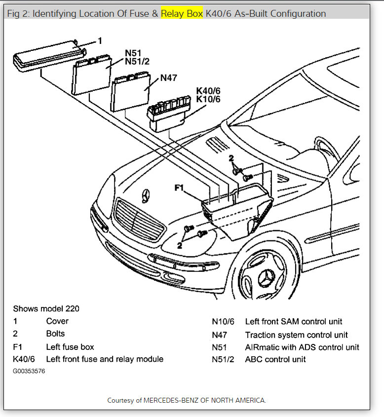

There is a airmatic control relay that wound like it is not working here is a guide to help you test it and the location of the relay along with the wiring diagrams for the system so you can see how it works.
Check out the diagrams (Below). Please let us know what you find. We are interested to see what it is.

Thank you for this guide! It was the relay on my car I fixed it for $32.00 :) I love this site.

This is a very common issue on this vehicle. The air pump relay sticks causing the pump to over amp, which takes out he maxi fuse. The repair will require a new air suspension pump, 40 maxi fuse and pump relay.

If the vehicle is on the ground in the front and will not raise then yes you have a failed relay. However the airmatic pump gets fryed when the relay sticks in the on position, burning the pump and the 40amp maxi fuse in this circuit. You will have to replace the 40amp maxi fuse, the airmatic pump and the relay. The relay and fuse are located in the fuse box on the passanger side engine compartment. Look for the 40 amp maxi fuse in this box. If it's blown then this is your problem. If not then you have leaking strut towers for the front shocks. This is not a repair that can be done at home as it requires special MB tools to perform. Let me know what you find and if necessary I can walk you through the replacement of the air pump. It's not terribly difficult to replace.
