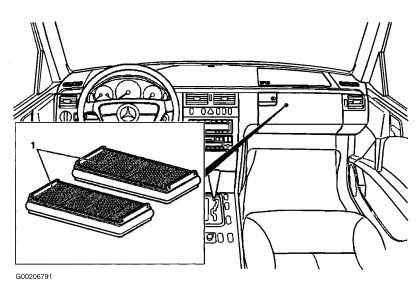

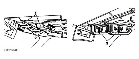

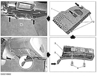

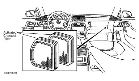

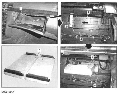

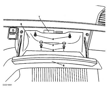

How to replace cabin air filter, Mainly the access cover and how many screws?
Oct 11, 2008 at 12:47 AM
2CARPRO JACK
  • 11,533 POSTS
That car has 2 kinds of filter, activated charcoal and cabin filters. Charcoal- remove lower panel under dash.they are located in the plenum. see pics for removal/installation

The cabin filters aer located right behind the glove box. You will have to remove it to gain access to them'
