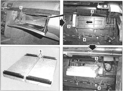

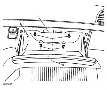

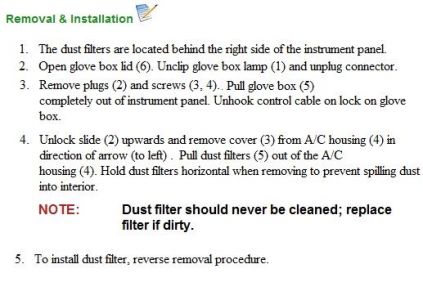

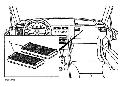

I would like to know where is cabin filter in this car and how to replace it.
