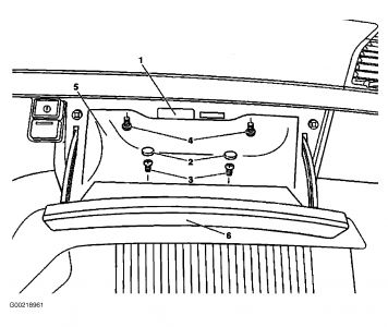

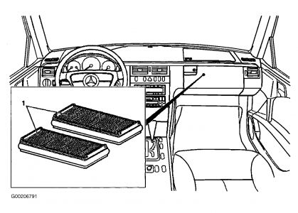

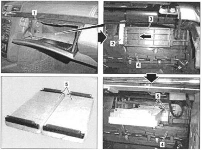

the cabin dust filters are located behind the right side of instrument panel, behind glove box..

How do I replace a dust filter in s500 merceds- year 2000.
