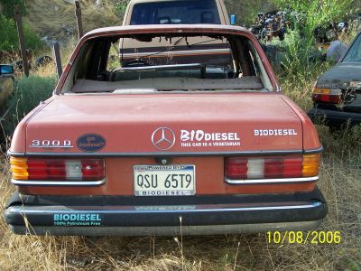

People that are in to bio-diesel know that the Mercedes injection pump is the only pump that will handle bio-diesel with out being preheated, except when it gets cold. since you did not tell me the chemical make-up of your bio-diesel I cannot give you good advice, except the only stuff I have ever found to work is Chevron Textron injector cleaner, take off the fuel filter and put in 1/2 the bottle in and put the ather 1/2 in the tank that should do it. now I have some time to B.S. if you remember the movie unsupervised teens, ( I think that was the name, I supply hundreds of car for WB I cant keep all the movies straight) filmed by Warner Brothers I supplied them two 1978 Mercedes 300D for the bio-freak in the movie, I thought you would like to see it.
https://images.2carpros.com/forum/automotive_pictures/307270_100_0503_2.jpg
