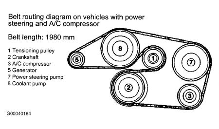

I need to know how the serpentine belt goes on my 1992 300e any type of diragram for this car

Hi there ,
I believe that this is the layout you need If not please advise Chassis No.
