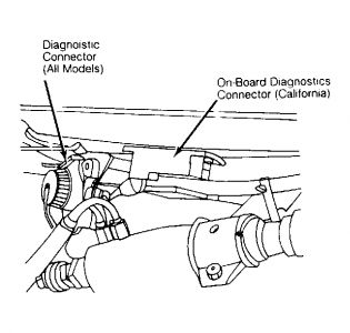

A common reply to a question you cant answer! Why even reply if you are gonna give a standerd try this try that response!, Heres one for you. Can you run a diagnostic test on an 89 benz? If you can answer this right, I will respect your advise, if not.

For a 1989 260 E the diagnostic link connector is on the left front fender. see pic.
https://www.2carpros.com/forum/automotive_pictures/61395_Graphic_20.jpg
