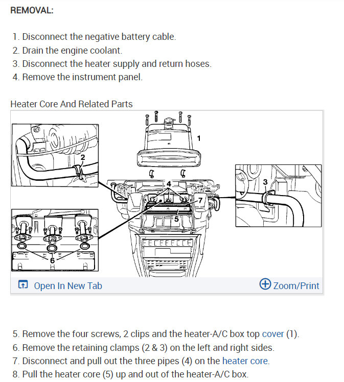

you have to remove dash and heater box . be careful .
Jan 5, 2008 at 2:46 AM
  • 54,858 POSTS
Here are the instructions on how to replace the heater core in your car as requested. Check out the images (below). Let us know if you need anything else.
