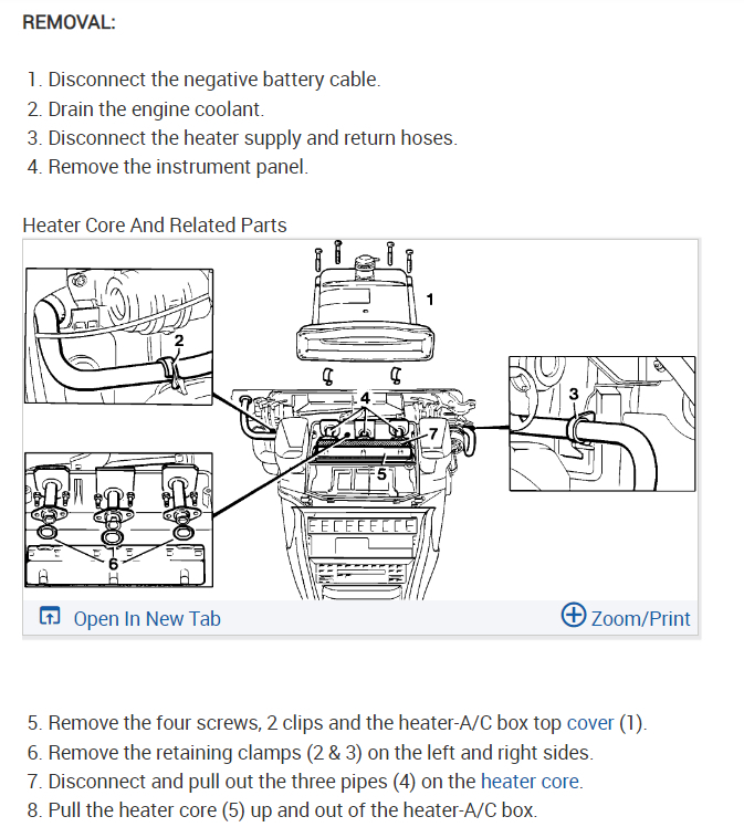

you have to remove dash and heater box . be careful .

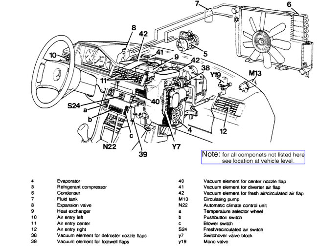

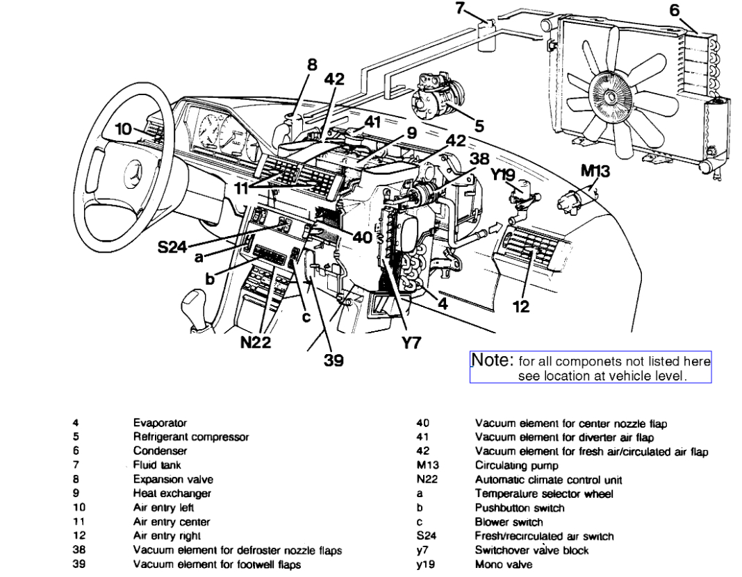

Here are the instructions on how to replace the heater core in your car as requested. Check out the images (below). Let us know if you need anything else.
