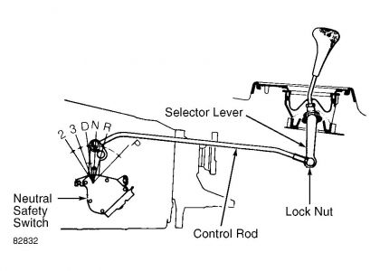

I am looking for information on replacing a neutral safety swith on transmission for an 1988 Mercedes 560 SEL.
Standed and don't know how much it should cost.
Appreciate any help.

Locate the switch on the tranny remove shifter cable link (rod) remove hold down bolts
https://images.2carpros.com/forum/automotive_pictures/99387_benz_1.jpg
Looking to spend under $200 I thing the switch about $60 and about an hr of labor
