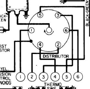

1972 Other Mercedes Benz Models 6 cyl Wheel Drive Type unknown Automatic 72,003 miles
My brother changed the spark plugs & wires in my father's 1972 Mercedes 280SE on a 108 chassis (if that matters) and did not mark which wire went to where on the distributor cap. I'm trying to find a diagram that shows where to put what spark plug wire where on the distributor cap, while holding my father down so my little brother has a head start running. Any help would be greatly appreciated.
Mar 28, 2008 at 12:10 PM
SERVICE WRITER
  • 9,123 POSTS
LOL Funny story...He's the one that wanted kids lol... Try this:
https://images.2carpros.com/forum/automotive_pictures/30961_sel6_1.jpg

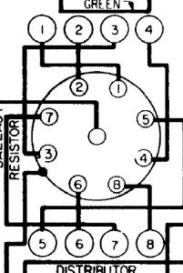

Not sure what the deal is, the 6 and the 280se wern't coming up together, so here's the 8:
https://images.2carpros.com/forum/automotive_pictures/30961_sel8_1.jpg
