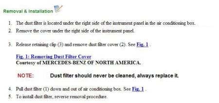

dear sir ,
i would like to change my benz cabin filter,is it easy to replace that one or i want go to any auto shop to replace that one
thanks
ED
Mar 24, 2009 at 1:27 PM
BLUELIGHTNIN6
  • 16,542 POSTS
Replacement procedures are below for your vehicle's cabin filter (aka dust filter)

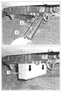

FIG. 1
