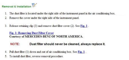

dear sir ,
i would like to change my benz cabin filter,is it easy to replace that one or i want go to any auto shop to replace that one

Replacement procedures are below for your vehicle's cabin filter (aka dust filter)
https://images.2carpros.com/forum/automotive_pictures/261618_Noname_356.jpg
FIG. 1
