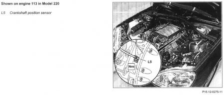

how do you replace the crank position sensor and where is it located in the engine?

Remove/Install Crankshaft Position Sensor Shown On Engine 113 In Model 220
https://images.2carpros.com/forum/automotive_pictures/12900_c_11.jpg
Work Instructions NOTE: Remove Air cleaner (engine side). Crankshaft position sensor to engine block - 8 N.m NOTE: If the crankshaft position sensor (L5) was replaced, a re-initialization must be carried out with STAR DIAGNOSIS in the menu item control module adaptations. https://www.2carpros.com/kpages/auto_repair_manuals_alldata.htm
