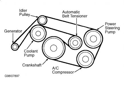

I would like the routing of the serpen belt the old one ripped of of my mother in laws truck. Thanks Jason

The belt routing is as follows Check out the diagrams (Below). Please let us know if you need anything else to get the problem fixed.
https://images.2carpros.com/forum/automotive_pictures/294900_Ml430_belt_routing_1.jpg

My belt in the engine broke and i put a new one on and it shredded apart. I beleive that it is missing a wheel thing that the belt runs on. I can not find what the engine is supost to look like? Is there supost to be a plastic wheel on the top (highest) wheel? cause all i have is metal no ribbed peice like all the others?

There are smooth pulleys, these are the pullys that run the back side of the belt not the ribbed side. The following is the belt routing diagram for your vehicle. Look at the diagram to determine if the pulley you are speaking about is one the should be ribbed or not (the outer pulleys should all be ribbed side in). From your description it sounds like you are speaking of the Idler pulley which should have ribbing on it.
https://images.2carpros.com/forum/automotive_pictures/294900_Ml430_belt_routing_2.jpg
