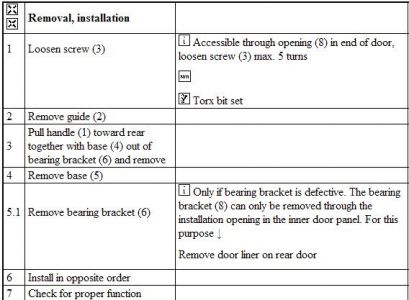

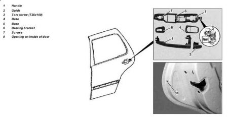

I am changing the rt rear door lock assy. Almost got it out but am hung up on the outside door handle.
How do you take outside handle off - how does rear cover come off ??? Have pried at it some but i am afraid it will break.
Does anything else have to come out to change the lock assy????

https://images.2carpros.com/forum/automotive_pictures/261618_Noname_1469.jpg
https://images.2carpros.com/forum/automotive_pictures/261618_Noname2_429.jpg

YOUR INFO ON DOOR HANDLE WAS "RIGHT ON"
USUALLY I AM IMPRESSED WITH GERMAN ENGINEERING - THINK "RUBE GOLDBERG" HELPED DESIGN REAR DOORS ON THIS SUV !!!!
