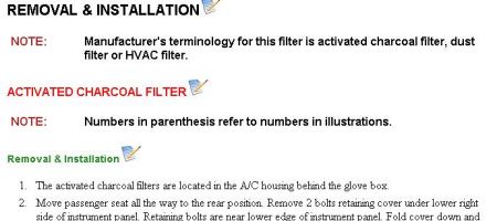

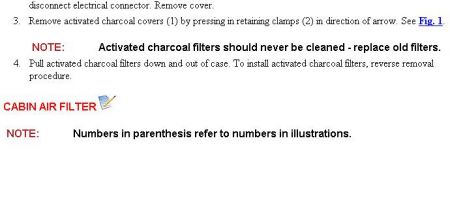

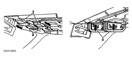

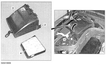

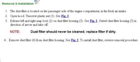

How to I get access to the old filter to replace it.
