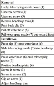

How do you access the headlight washer nozzles

Thanks, I will try this. Lebrown
