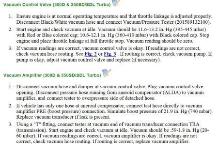

This car idles ok (rpm is 700) when it's in park or netural but, when the car in drive the Tac goes from 500rpm to 750rpm at one sec intervals. The car has 161000 mi and is in good condition otherwise. The vin is as follows:
WDBEA34E8RC078952
Mar 20, 2009 at 9:32 AM
KHLOW2008
  • CAR REPAIR CONTRIBUTOR
  • 41,814 POSTS

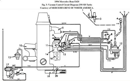

Hi sunderdue, Thank you for the donation. The symptoms described indicates a vacumn leakage causing the engine to hunt.
