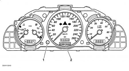

2007 Mercedes Benz E350 maintenance indicater on dash board
2007 MERCEDES BENZ E350
KURT2403
Computer problem
2007 Mercedes Benz E350 6 cyl Four Wheel Drive Automatic
How do you turn off the Maintenance indicator on the dashboard
Feb 7, 2010 at 1:00 PM
2CARPRO JACK
  • 11,533 POSTS
Turn ignition switch to position 1. Then press and hold button 1 while turning ingition to position2.After 10 seconds a chime will sound and it should be reset
