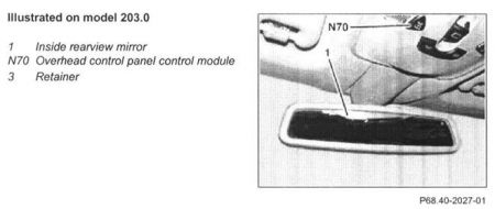

Hi toxic2,Welcome to 2carpros and TY for the donation. AR68.40-P-0001P Remove/Install Inside Rearview Mirror Illustrated On Model 203.0
https://images.2carpros.com/forum/automotive_pictures/12900_m1_2.jpg
https://images.2carpros.com/forum/automotive_pictures/12900_m2_2.jpg
1.Unclip overhead control panel control module (N70) 2.Pull inside rearview mirror (1) down at one side NOTE: The inside rearview mirror is held by spring tension 3.Disconnect connector from overhead control panel control module (N70) 4.Remove inside rearview mirror (1) NOTE: Installation Press spring bolt (2) together with pliers (arrow) and allow retainer to catch (3) 5.Install in the reverse order.
