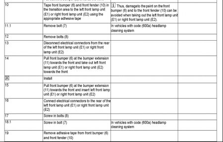

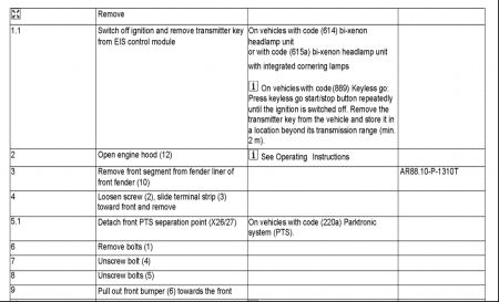

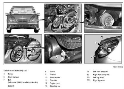

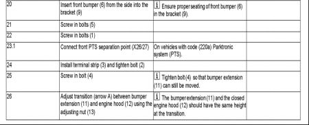

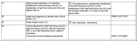

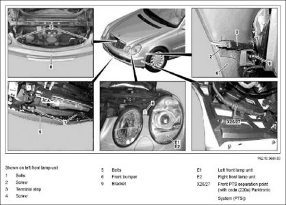

How can I replace the headlight assembly on this car?
Jan 1, 2009 at 10:22 AM
IMPALASS
  • 3,112 POSTS
Hello - The best I can do is for a 2008 E320. Not all the data for the 2009 has been released. Does this help you out? AR82.10-P-4730TA Remove/Install Headlamp Unit - When removing the left or right front lamp unit
