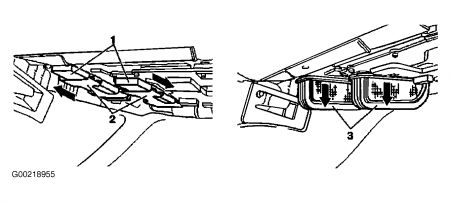

Where is the charcoal cabin filter ? It is not under the passenger side dashboard or behind the glove box !! . someone said it is inside the heater case but where exactly is it ? Please help !!!!!

The charcoal cabin filter is in the HVAC box behind the glove box. Here is a pic of where they are, it is kind of crude but the only pic Mitchell has
