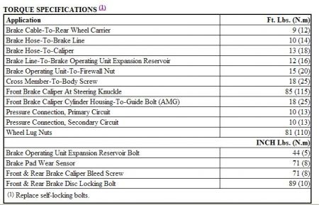

I want to change the front and rear brake pads and rotors on my 2004 E320 and need the torque specs for the front and rear calipers. I'm pretty sure the rear is less than the front.

https://images.2carpros.com/forum/automotive_pictures/261618_Noname_312.jpg
