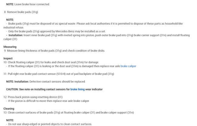

Rear brake pads need to be replaced. Dealership says needs new rotors as well as they are "out of specs"..

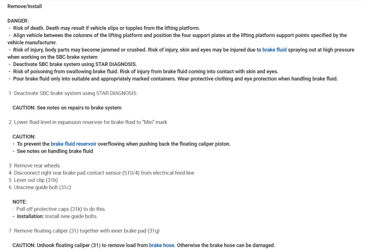

1. do I need to replace the pad sensors?
2. do I need to disable the electronic brake system before proceeding? and if so, can I do it without a computer or special tool?
thanks!
Brian.
Aug 28, 2010 at 3:08 PM
MHPAUTOS
  • 31,937 POSTS
Hi there,

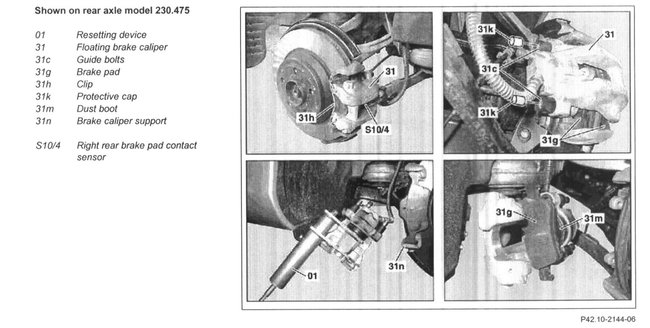

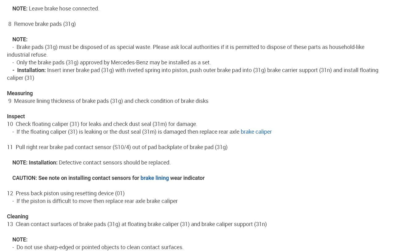

Pad sensors should be replaced if they have any wear on them, as for the rotor removal. Here is a guide and the diagrams below to show you how the do the job.
This guide will give you an idea the diagrams below are specific.
https://www.2carpros.com/articles/how-to-replace-rear-brake-pads-and-rotors
Cheers, Mark (mhpautos)
