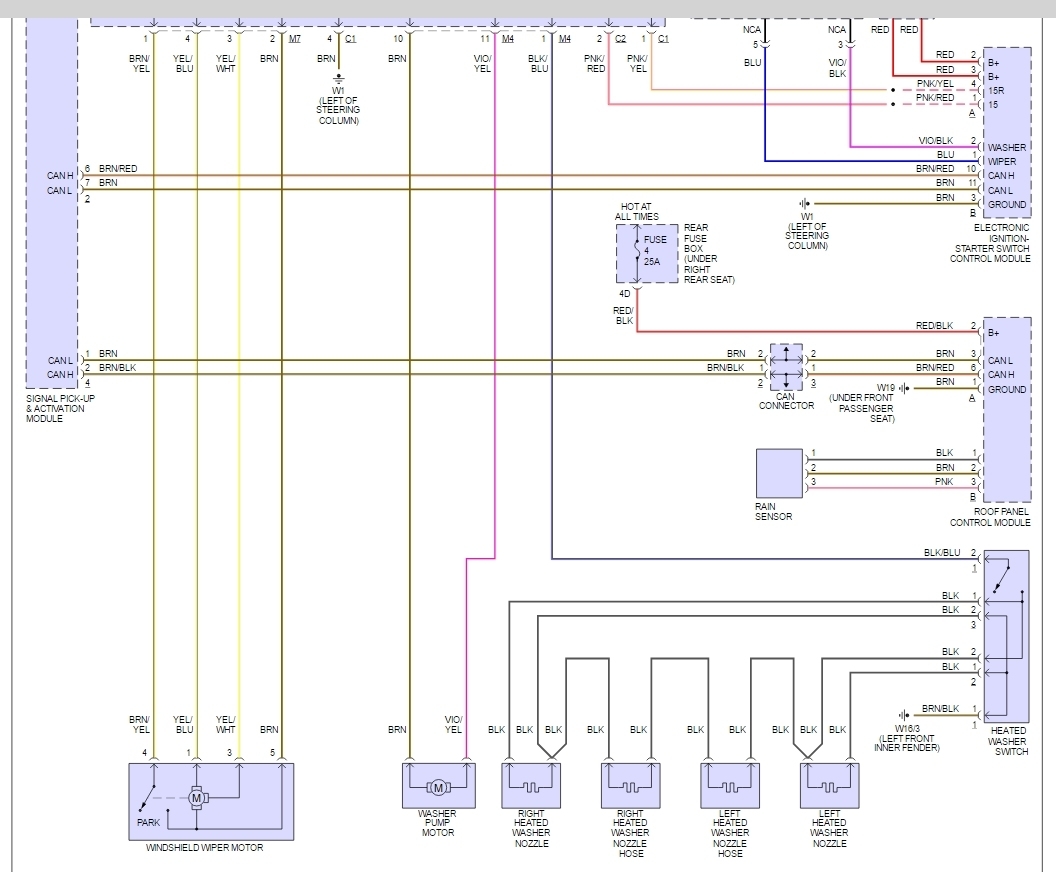

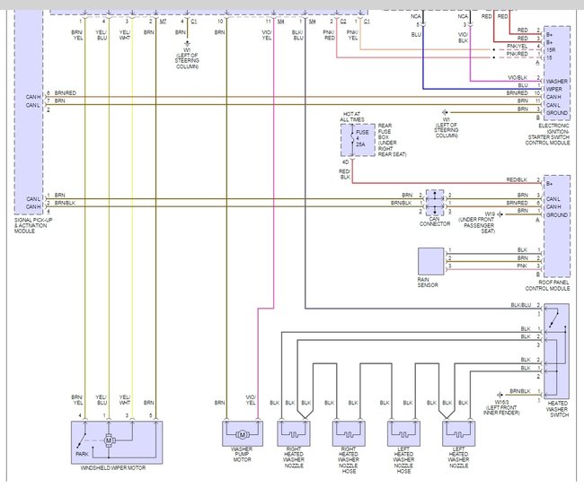

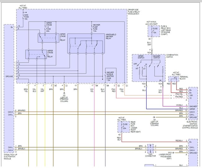

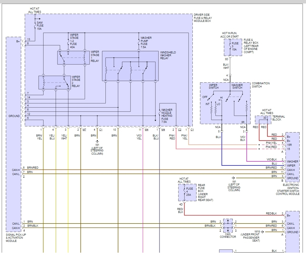

wipers don't work, dash light don't come on, radio doesn't come on, where are the fuses/ and relays located

They are under the hood, here is a couple of diagrams that should help you.
Please let us know what you find so it will help others.
