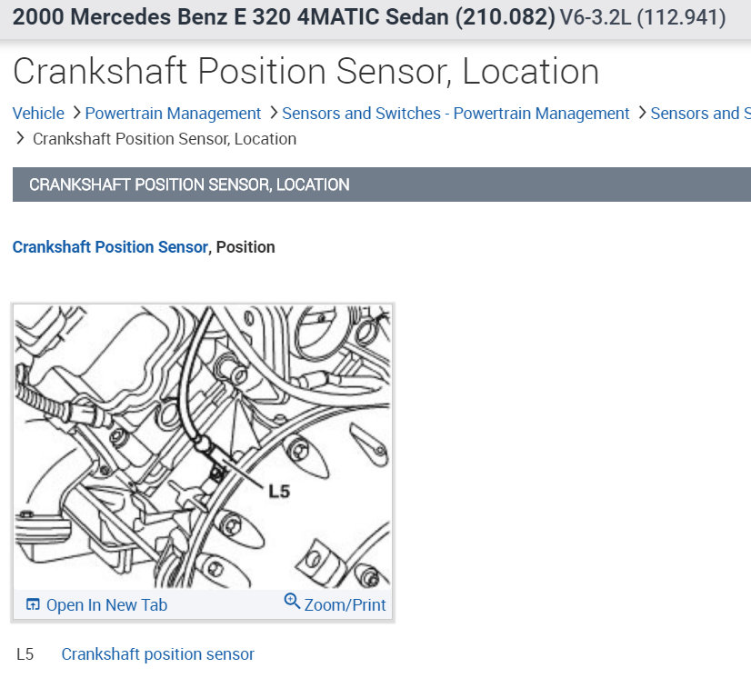

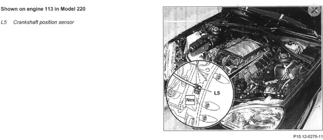

  • 54,840 POSTS
Yep, this sounds like a classic crankshaft angle sensor which when they go bad they do not set a code. Here is the location so you can change it out. Check out the diagrams (below). Please let us know what happens.
Aug 1, 2019 at 10:32 AM
CORTEZ22
Hey Ken sorry for responding so late but that exactly what it was the Crankshaft Position Sensor it was pretty easy to replace if you using the right E-8 socket thanks again for your help.
