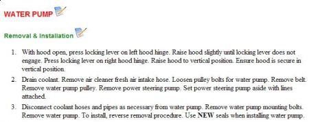

my temp gauge came on and i filled the car to level drove to work short way. 16 mile round trip and leaked a little both times, bottom area under water pump wet. how do i replace the the water pump. I"m mechanical but unemployed at moment so any advice would be greatly appreciated

https://images.2carpros.com/forum/automotive_pictures/261618_Noname_502.jpg
