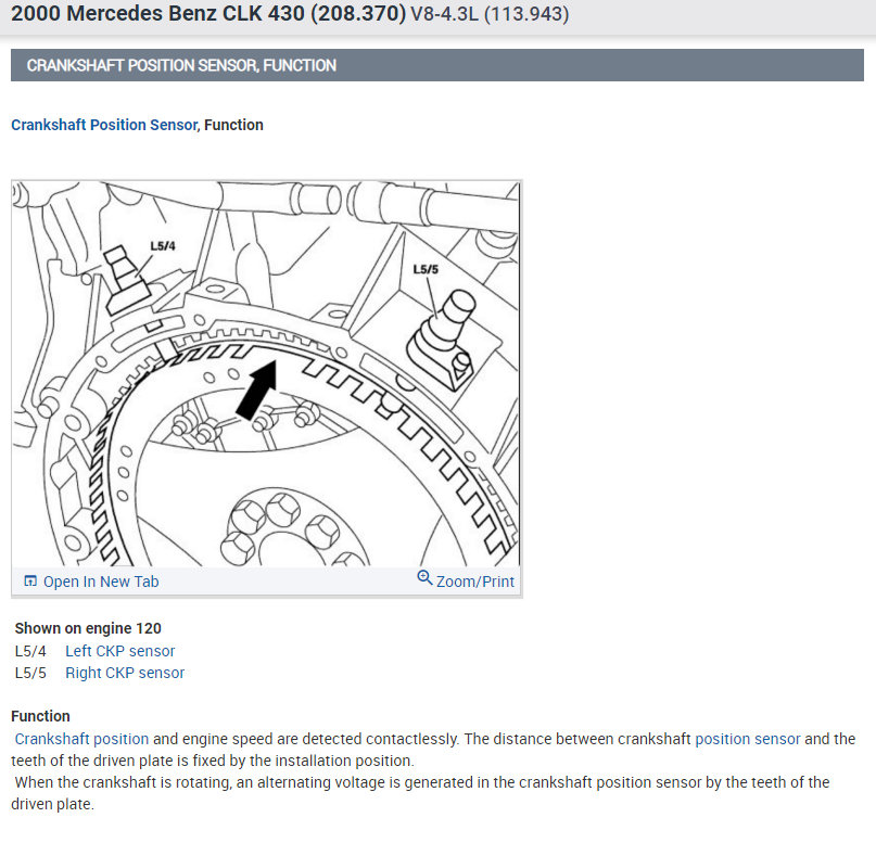

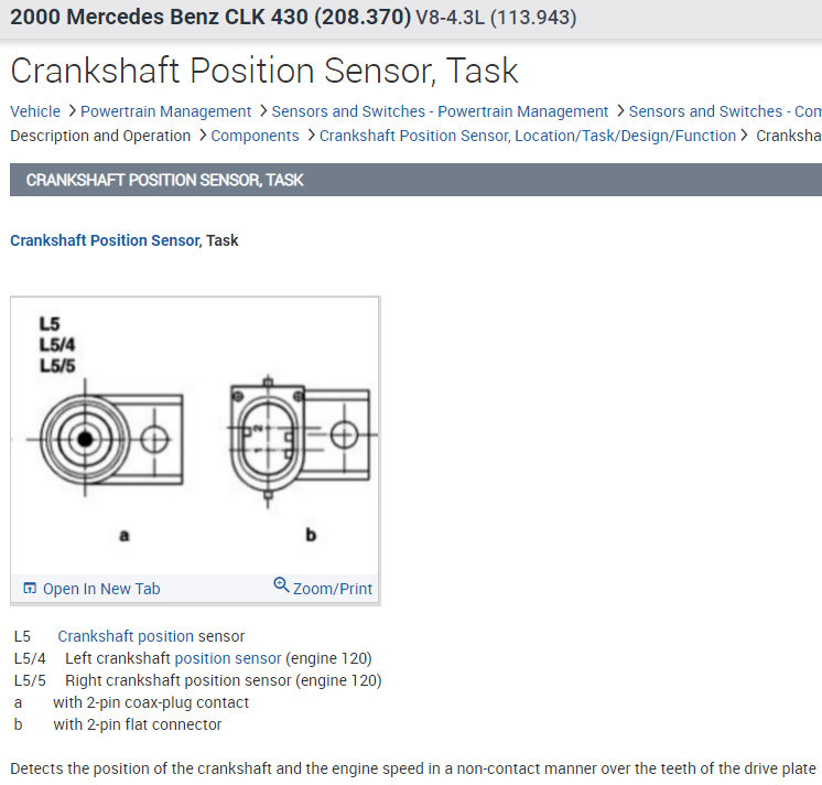

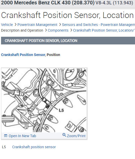

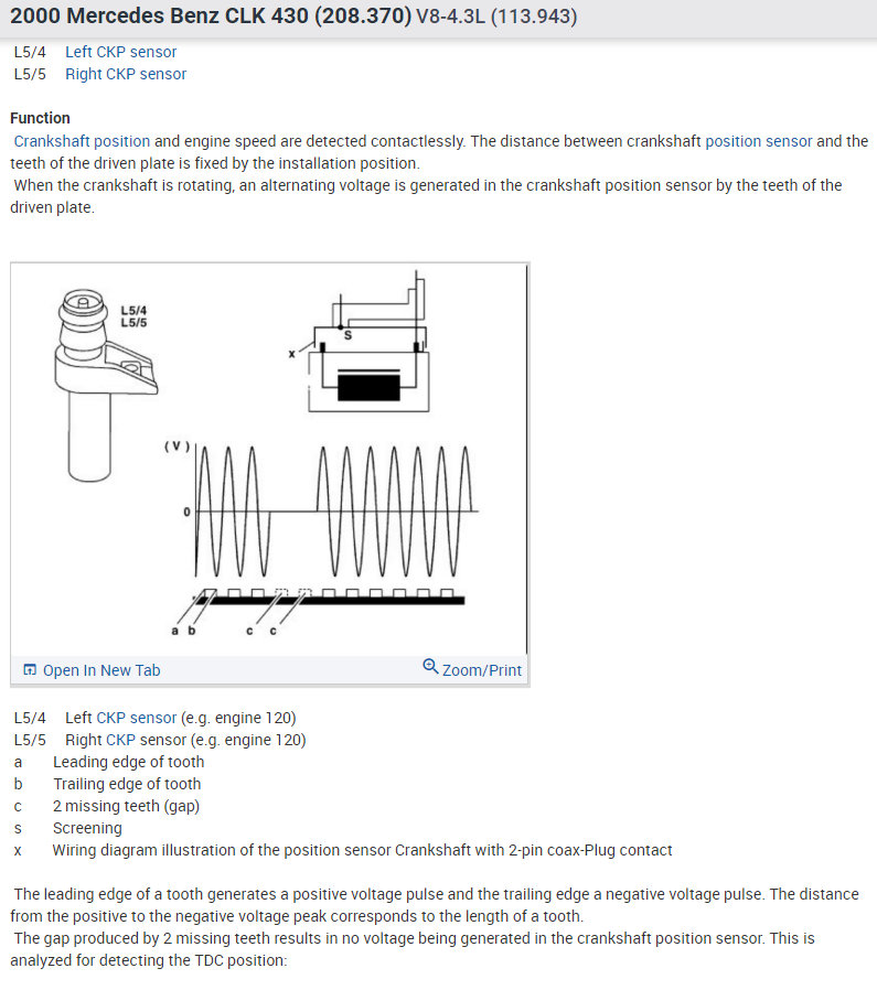

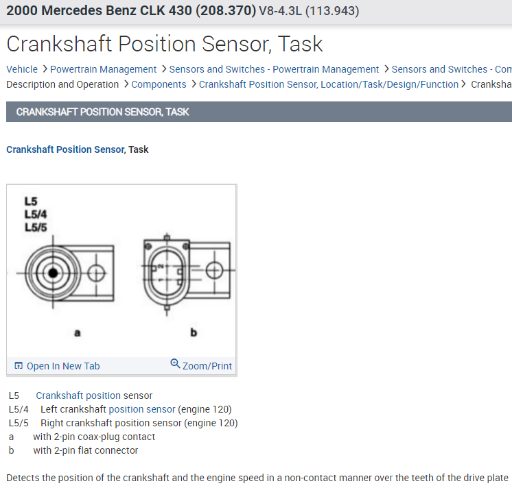

Where is the crankshaft sensor located and how can I change it.
Thursday, June 18th, 2009 AT 11:21 PM
SQM
MECHANIC
6,383 POSTS
The crankshaft position sensor is located at the back of the engine by the flywheel housing, in front of the firewall.
Here are few helpful articles:
https://www.2carpros.com/articles/how-a-crank-shaft-angle-sensor-works
I have attached the replacement instructions.
