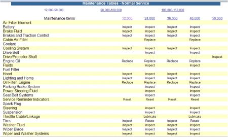

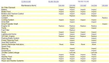

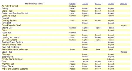

2003 Mercedes Benz CLK320 41000 miles
what is the proper mileage for a tuneup

Hello -Here is the info you requested.
https://images.2carpros.com/forum/automotive_pictures/248015_Maint_1_1.jpg
https://images.2carpros.com/forum/automotive_pictures/248015_Maint_2_1.jpg
https://images.2carpros.com/forum/automotive_pictures/248015_Maint_3_1.jpg
