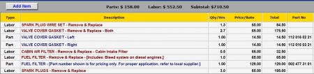

My car started to shake while in gear and in idol. Unfortunately I can't afford to take it to multipule places for estimates. Your advise would be very apprieciated.
We took it in and were told the following needed to be done.
*Replace ignition wires
*Replace 2 cover gaskets on top of engine that are leaking oil onto spark plugs.
*Replace cabin filter
*Replace fuel filter
*Clean spark plugs
All parts and labor $800 total.

your quote seems fair, below is what i get for an estimate which includes all labor and partial parts, some parts were not listed so add that into the total and it comes close to the 800 you are quoted...
https://images.2carpros.com/forum/automotive_pictures/261618_Noname_2675.jpg
