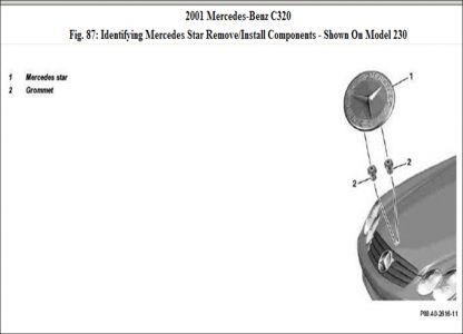

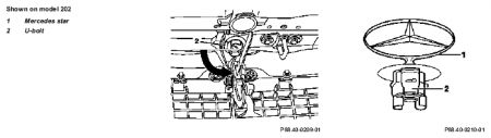

Hi Guys, this winter my coworker was walking buy the front of my car---slipped on the ice ---and grabbed my hood emblem to catch his fall---breaking it off the hood. I bought a new certified Mercedes hood emblem online, thinking it would be easy to replace. I can not figure out how to pop off the old emblem!! It has to be pushed up-and-out from the underside somehow---but i can't figure it out----any suggestions??? It's probably something easy---but I can not figure it out---many friends have looked at it also.....Thank You, Scott Fallon , Bristol CT

Hello - Not sure which body model you have but I have attached the removal installation of both. Looks like you need a special tool.... REMOVE/INSTALL MERCEDES STAR - AR88.40-P-4050E MODEL 202, 203.0 /2, 208.3 /4, 210, 220, 211.0 /2 /6 Shown on model 202
https://images.2carpros.com/forum/automotive_pictures/248015_f85_1.jpg
Fig. 85: Identifying Mercedes Star Remove/Install Components - Shown On Model 202 Remove 1 Open engine hood Model 202 AR88.40-P-1000E Model 203 AR88.40-P-1000P Model 208.3/4, 210 AR88.40-P-1000F Model 211 AR88.40-P-1000T Model 220 AR88.40-P-1000M 2 Turn spring bracket (2) 90 ° to left with assembly tool Fig. 86 3 Remove Mercedes star (1) upward from engine hood Carefully remove Mercedes star (1). Danger of damaging paint. Install 4 Insert Mercedes star (1) from above into engine hood Carefully install Mercedes star (1). Danger of damaging paint. 5 Turn spring bracket (2) 90 ° to right with mounting tool Note correct installation positions. Fig. 86 6 Close engine hood Model 202 AR88.40-P-1000E Model 203 AR88.40-P-1000P Model 208.3/4, 210 AR88.40-P-1000F Model 211 AR88.40-P-1000T Model 220 AR88.40-P-1000M Fig. 86: Identifying Assembly Tool (202 589 11 63 00)
https://images.2carpros.com/forum/automotive_pictures/248015_f86_1.png
REMOVE/INSTALL MERCEDES STAR - AR88.40-P-4050R MODEL 163, 203.7, 215, 230.4 Shown on model 230
https://images.2carpros.com/forum/automotive_pictures/248015_f87_1.jpg
Fig. 87: Identifying Mercedes Star Remove/Install Components - Shown On Model 230 Remove/install 1 Unclip Mercedes star (1) upward from engine hood with long wedge. Protect engine hood around Mercedes star (1) with adhesive tape to avoid damaging paint. Fig. 31
https://images.2carpros.com/forum/automotive_pictures/248015_f31_1.png
2 Remove grommets (2) Check grommets (2), replace if necessary. 3 Install in opposite order Fig. 88: Identifying Long Wedge (115 589 03 59 00)
