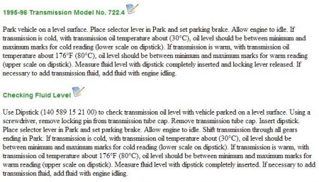

How do you check transmission fluid level?

https://images.2carpros.com/forum/automotive_pictures/261618_Noname_1094.jpg
