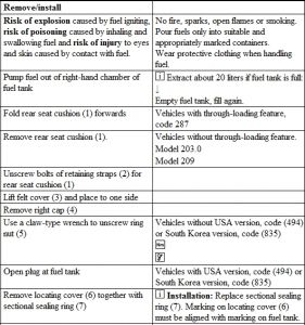

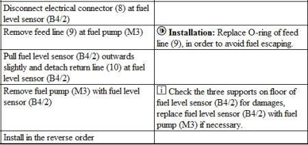

How do you replace the fuel pump on a 2002 C240?

https://images.2carpros.com/forum/automotive_pictures/261618_Noname_2532.jpg
https://images.2carpros.com/forum/automotive_pictures/261618_Noname2_825.jpg
