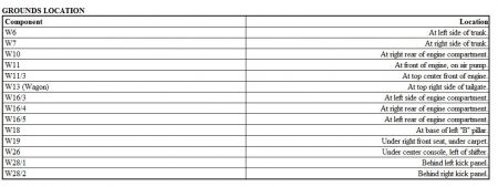

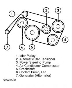

Hello, is there a diagram that shows one how to put back on a belt for my car? Also, where is the engine ground located? I think i need to replace it due to the fact that i had both my alternator and battery checked and they are both good! Thanks

Belt routing and ground locations.
https://images.2carpros.com/forum/automotive_pictures/61395_Graphic_150.jpg
https://images.2carpros.com/forum/automotive_pictures/61395_grounds_1.jpg
