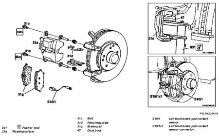

How to replace front brake pads
Apr 5, 2010 at 2:26 AM
DAVE H
  • 13,383 POSTS
Hello .. thanks for the donation .. much appreciated Remove the front wheels 2Detach left front brake pad contact sensor connector (S10/1x1) 3.1Remove bolts (31c) and detach floating brake caliper (31a) upwards Tie floating brake caliper (31a) to body. Check dust boots (47) on floating brake caliper (31a) for damage. 3.2Drive out retaining pins using a punch and remove retaining plates 4Remove brake pads (31g) .. Install in the reverse order
