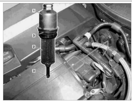

Need to know the location for the oil filter?

The oil filter is located near the rear of the engine up top intake side. Here is a video of an intake job being done so you can see the oil filter.
https://www.youtube.com/watch?v=eXxkOXNvQjA
Here is a guide to help you see how to change the oil.
https://www.2carpros.com/articles/how-to-change-engine-oil-and-filter
See oil filter diagram below.
