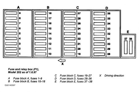

What is the fuse numbering system in the fuse panel?
Dec 22, 2008 at 8:02 AM
GFIMOTORCARS
  • 673 POSTS
The fuse numbering diagram is as follows:
https://images.2carpros.com/forum/automotive_pictures/294900_MB_202_Fuse_Panel_1.jpg
