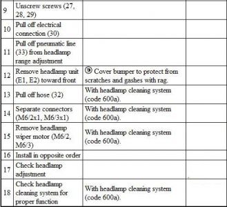

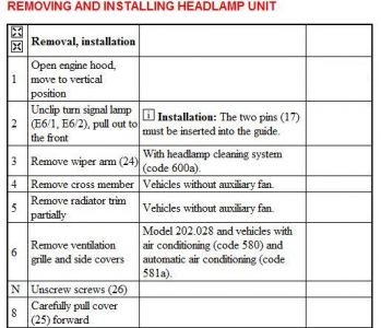

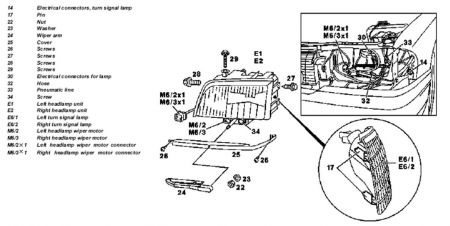

how do you change out the headlight assembly? Have a major crack across the front glass.

Sorry about that. I have attached the same answer to an email, it should upload much larger through email than it does in the forums. Let me know if you have any more questions..
