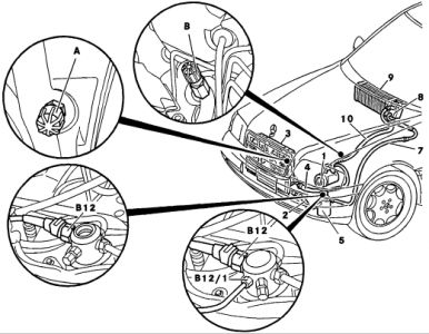

I was looking to put some 134a in my car but, I couldn't find the lower hose to hook it up. Could you show me a pic. or tell me where it is located?

See below for location of low pressure connection:
https://images.2carpros.com/forum/automotive_pictures/12900_s_15.jpg
A High pressure connection B Low pressure connection
