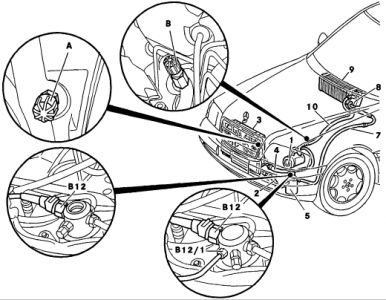

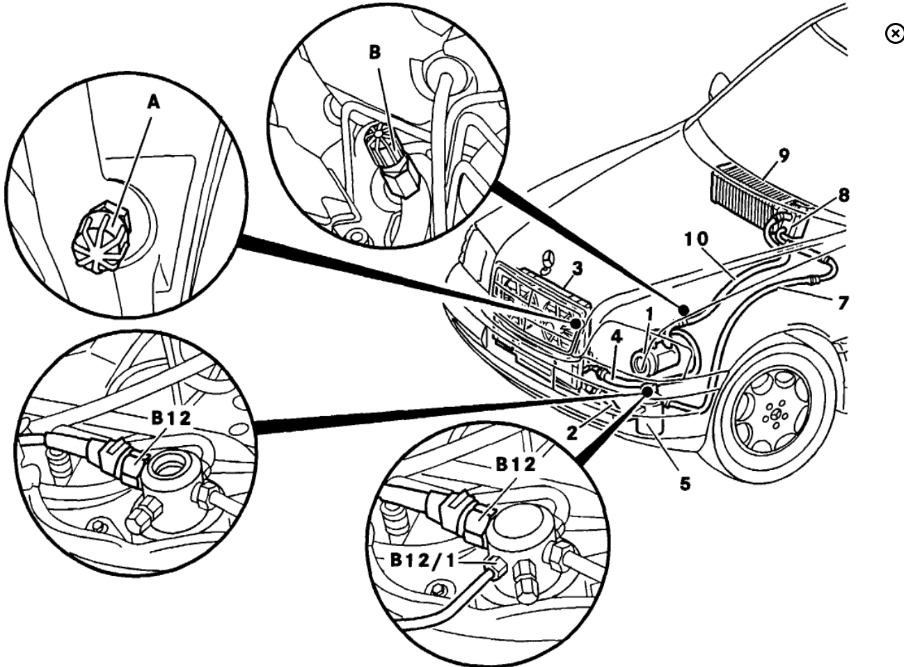

Where is a/c refrigerant service port can you tell me where it is please?
Jun 12, 2010 at 5:16 PM
  • 54,858 POSTS
Here are some guides and diagrams below that show the high and low service ports. This guide will help you get the air conditioner serviced. https://www.2carpros.com/articles/air-conditioner-how-to-add-freon and
https://images.2carpros.com/forum/automotive_pictures/12900_merc_2.jpg
LARGER IMAGES BELOW Please use 2CarPros anytime, we are here to help. Please tell a friend. Cheers, Ken
