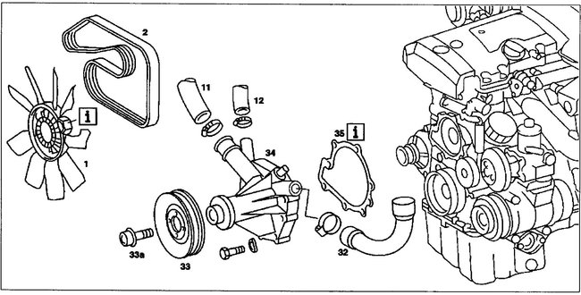

water pump replacement diagram
May 24, 2010 at 6:19 AM
BLUELIGHTNIN6
  • 16,542 POSTS
Heres a guide on replacing a water pump, not vehicle specific but it will give you some guidance
https://www.2carpros.com/articles/water-pump-replacement
1 Remove viscous fan clutch (1)
- Engines with viscous fan clutch
NOTE: Left-handed thread
2 Drain coolant
- Radiator and crankcase.
3 Disconnect coolant hoses (11, 12 and 32)
- Check condition of engine coolant hoses and hose clamps and replace if necessary.
4 Loosen combined bolts and washers (33a) on belt pulley (33)
5 Remove poly V-belt (2)
6 Unscrew and remove engine coolant pump belt pulley (33)
7 Unscrew and remove engine coolant pump (34)
NOTE:
- The engine coolant pump of engines 111.943/944/973/975 with compressor is extended by 29.5 mm
- Installation: Clean sealing surfaces. Engine coolant pumps which were originally sealed with liquid sealant can be sealed with liquid sealant or a paper gasket (35) in the case of repair.
8 Install in reverse order
9 Check cooling system for leaks.

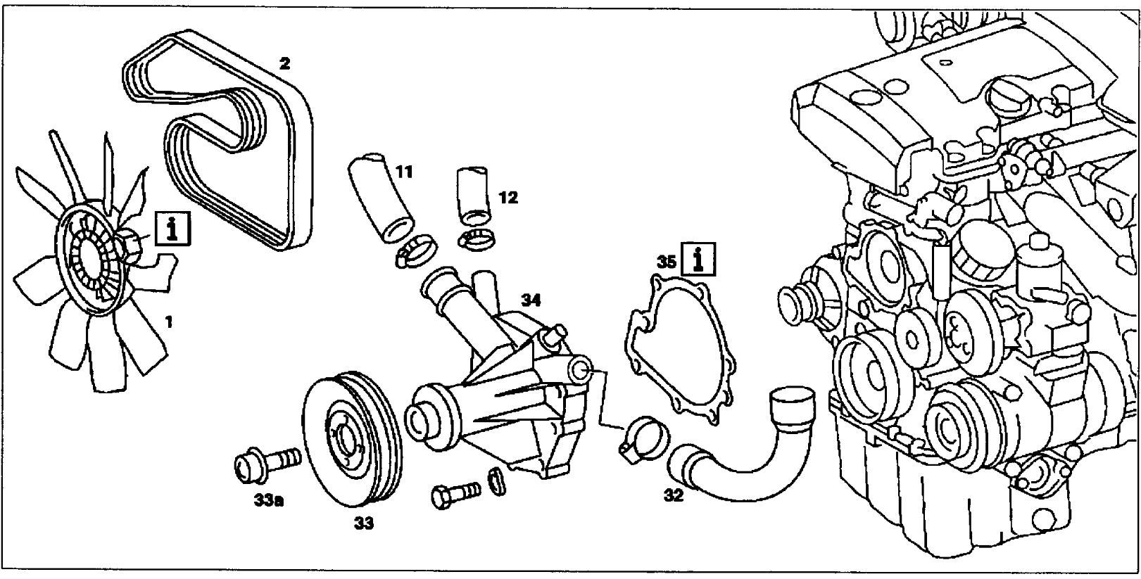

See the diagram below
