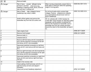

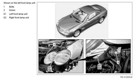

Step by step removal of passenger side headlight assembly?
Jul 23, 2010 at 7:28 AM
  • 75,992 POSTS
Hi Edward Forbes, Welcome to 2carpros and TY for the donation See below removal procedures
https://images.2carpros.com/forum/automotive_pictures/12900_h_3.jpg
https://images.2carpros.com/forum/automotive_pictures/12900_h1_16.jpg
