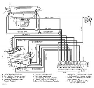

how do you replace the blower mtr,blwr regulator,cradle on a 1999 sl500?

BLOWER MOTOR Removal & Installation Remove windshield wipers and motor. Remove left and right water drains. Remove 2 center partition wall rivets and screws. Detach vacuum lines. Remove 8 blower motor housing screws. Detach 6 blower motor housing clips. Detach blower motor retaining strap. Remove blower motor. To install, reverse removal procedure.
https://images.2carpros.com/forum/automotive_pictures/307270_Graphic_500sl_1.jpg
