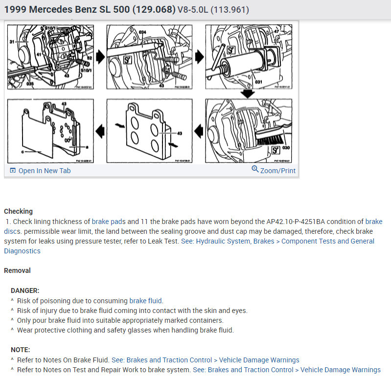

Regardless of the vehicle when changing the brake pads, it is recommended to inspect the rotors make sure that it is within specification and have the rotors resurfaced before installing new pads.
Only time rotors needs to be changed if they are below the minimum thickness and or are wrapped beyond limit.
So changing the rotors just so you are replacing the pads are not necessary.

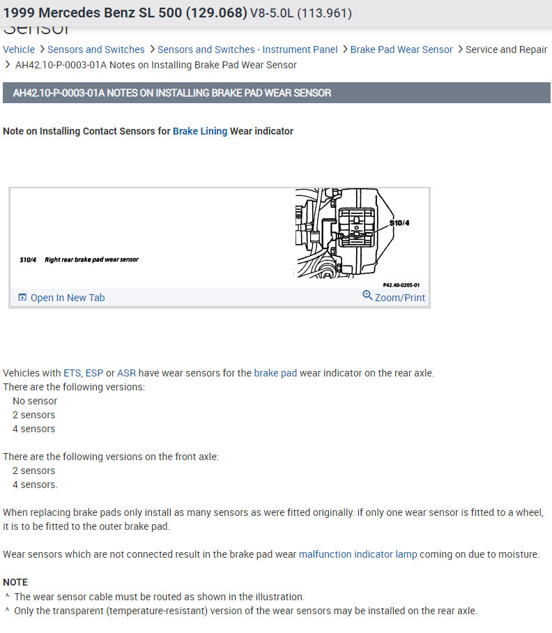

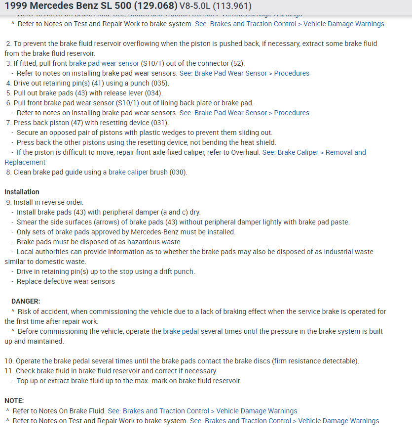

When the pads are changed you will have to replace the brake pad wear sensor. If that does not get changed, the brake pad replacement light will stay illuminated.
Hope this helps.
