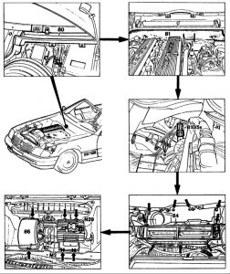

How do I get to the blower motor? Its making noise and seems to me I need to get at it through the dashboard somehow.

Removing and Installing Blower Motor
https://images.2carpros.com/forum/automotive_pictures/12900_blower_22.jpg
Wiper system remove. See: Wiper and Washer Systems\Wiper Motor\Service and Repair Left and right water drain (80) remove, 2 screws. Center partition wall (81) remove, 2 rivets, 2 screws. Vacuum lines (a) detach. Housing (84) remove, 8 screws, 1 rubber stopper. Cover (86) and blower controller (N29) remove by unclipping 6 clips (arrow). Retaining strap (87) unclip. Flat-blade connector at blower motor (M2) detach and withdraw blower motor. Install in the reverse order ensuring that the blower motor is correctly inserted into the mounting bracket. NOTE : Effective with 03/96 production, the overall dimensions of the blower motor have been changed. Special installation procedures are required. SEE SERVICE INFORMATION (TSB) P-SI-83.40/55 for installation instructions and further information
