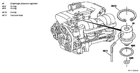

you also mentioned the fuel pressure regulator might be leaking? how do I tell if it leaking and how do I replace it? it is hard?

This is a specific faulty part so it will be necessary to check the part # to see if it is part of the faulty batch originally shipped. The faulty part # is: 000-078-15-89 (Brumme production code 06.95 and 12.95) The fuel pressure regulator is located as illustrated below. Diaphragm Pressure Regulator #40
https://images.2carpros.com/forum/automotive_pictures/294900_129_diaphragm_pressure_regulator_1.jpg
It will be on the driverside front of the motor. Along the fuel lines. You should see the part number on the regulator
