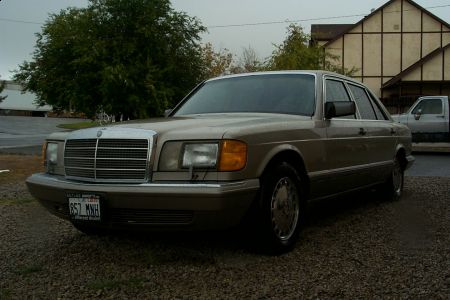

I had the same problem, I have a 560 SEL
https://images.2carpros.com/forum/automotive_pictures/307270_Picture_007_1.jpg
I have replaced: 1. The fuel filter; and, 2. The two fuel pumps; and, 3. The ignition control module; and, 4. spark plugs; and, 5. spark plugs wires; and, 6. cap and rotor; and, 7. engine computer; and, 8. fuel pressure regulator; and, 9. And all vacuum lines; this was the only car in 40 years, that kicked my A$$, I decided to remove the engine and put a Diesel in it, because it is such an awesome machine, as I began to remove the head, I found four cylinders cracked, I believe the car was going in to limp mode, it was using coolant, but very little, I did not think it was a problem, but my advice to you is, have the cooling system checked out.
