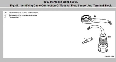

My bad, maybe I was looking at the wrong engine family?
https://images.2carpros.com/forum/automotive_pictures/170934_benz_air_flow_sensor_1.jpg
If you get the feeling I don't know what I'm doing, some days I get the same feeling. Thanks alot Mike.
Sep 28, 2009 at 8:29 AM
MOUNTIE55
  • 6 POSTS
( I miss-wrote my silly comment)..... " Which is WHY I am talking to you guys"... Trying to nail down cause, because I am getting different suggestions..... Thanks for that drawing ( small to read)..... But where is it located??

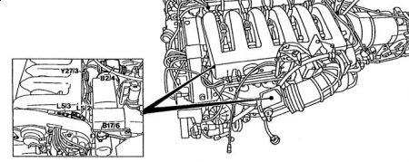

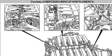

https://images.2carpros.com/forum/automotive_pictures/170934_mercedes_maf_sensor_1_1.jpg
https://images.2carpros.com/forum/automotive_pictures/170934_mercedes_air_flow_sensor_2_1.jpg
Sorry for the picture quality, I tried to magnify a little, If I magnify too much, you can't tell anything about the picture. B2/3 and B2/4 is the location. When I said," thanks alot Mike", Mike is my boss, he told me to take a look at your post. I guess I waited too long, Jack was already talking to you. I'll help anyway I can.

Thanks, much appreciated..... When I remove my large air box, you see a single 3" opening about in the center of the intake manifold, with the Throttle Actuator under it. The airfilter/airbox has a 3" opening in the center/bottom. I see no air sensors as shown.... I have air inlets on either side of airbox, into the airfilters, but no sensors. Hey, I notice your address is in Anaheim? I'm in Corona Del Mar.... ?? Possible to just drive the beastie to you? ( $) Donation?

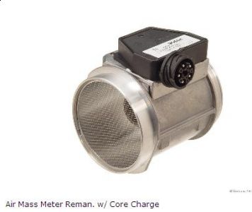

https://images.2carpros.com/forum/automotive_pictures/170934_mercedes_air_mass_meter_1.jpg
The picture came from a Mercedes parts book for your year make and model. I can't tell you what to replace, only make suggestions on what to check. Sometimes the databases and partsbooks are not correct, but, that is all I have to go on. Because this is an internet site, the people that help out here are from all over the world. I live in Oklahoma.
